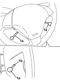

Arkadaşlar kendi çabalarımla buldum sonunda. Akşam gidince deneyeceğim. Tabii bu işlemi yapmadan önce akü kablolarını sökmek gerekiyormuş. Aşağıda sürücü havayastığının sökülüşü anlatılıyor ama sonuçta göbek söküldüğü için iş görecektir.
Before removing and refitting the Air Bag module the following preliminary operations must be carried out.
- Position the vehicle the front wheels straight.
- the ignition key to the OFF position and extract it.
- Dis the battery leads and insulate them.
- Wait for 10 minutes before continuing.
FOLLOW ALL THE RECOMMENDED SAFETY INSTRUCTIONS
https://www.fiatforum.com/attachment...1&d=1235822338
1. Insert tools (1a) fully home in holes (1b) on the steering wheel.
1. Push tools (1a) on the metal wires (1b) until they are released the steering wheel retainers (1c).
2. Move the Air Bag module slightly.
3. Dis the electrical (3a), (3b) and (3c).
4. Keep the Air Bag module.
Place the Air Bag module in the special cupboard resting it on a surface the bag facing upwards.
Refitting ( Removing )
- Observe the following precaution.
Handle the Air Bag module very carefully. sure that the battery is dised.
- If a new module is being fitted, position the labels. Remove the detachable part of the adhesive label the new module and place it in the special folder containing the vehicle details (model, registration date, chassis number) and the serial number of the old module. The file should be kept for future checks. A new adhesive plate comes together the module and should be stuck on top of the existing one. Beforehand, however, it should be perforated at the month and 14 years after the year in which the module is being fitted (e.g. 2005 for 2019).
- Position the Air Bag module ing the electrical .
- Push the airbag module its seat and engage the metail wires the two steering wheel retainers.
- the battery.
- Use an Examiner to check that the system has not acquired errors during the operation.
