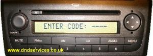

Aracımda Mp3 destekli Orjinal Blaupunkt Marka teyp var.

Teyp:
https://www.dndservices.co.uk/resize...00&new_height=
